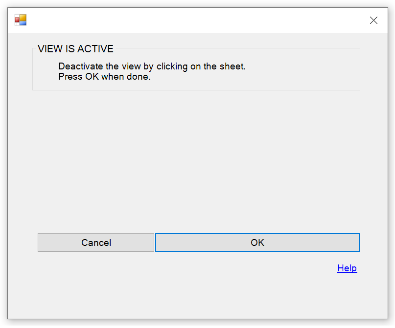

Here is an example where i need to set a view to inactive:
The userinterface wants the user to select views on a sheet, but it’s not possible because a view is active.

The script already works if i want it to when a sheet is active and a view is selected.
Adding the ability to also work if a view is active would have been a nice upgrade.
As you can see, when the Data-Shapes UI is running i am still able to set views inactive and active, and this is exactly what i would like to do with dynamo.
ezgif-2-5072e1e68c
I think i have to leave the idea that everything that is possible with the mouse in revit should also be possible with dynamo!?
As soon i hit the “select views” button i will get into the selection command, which i think is a standard revit command. when I´m in there and a view is active i can´t do anything. A workaround is i can hit “cancel”, inactivate the view and hit “select views” again. Not very user friendly.
So another workaround would be to let dynamo cancel this revit selection command:
But that again will not work because i can`t do anything with dynamo while this is running.
It seems that there is only one way to achieve what i want.
Giving the user the information that he has to deactivate the view himself before he can continue.
