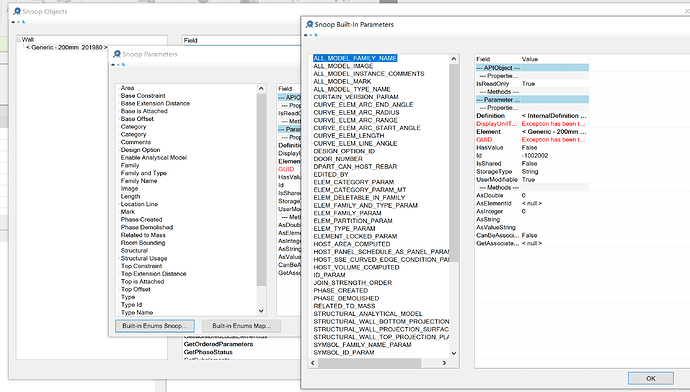

I mean is there a “sorting-criteria” in the Revit API. in a dictionary you have a alphabetical order.
How about the API or BuildInParameters? is it sorted by geometry? point, curve, survace,…
Or by Actions(methods), Query(Properties), how do i “snoop” in RevitAPI?
Just about everyone uses Revit Lookup.
And good luck making much sense out of the API until you have fought with it for a good while. There are a lot of items that don’t make much sense until you really get how a lot of elements are connected and why the parameters (BIP) are the way they are. Not saying its all perfect, far from that, but it just takes some time.
