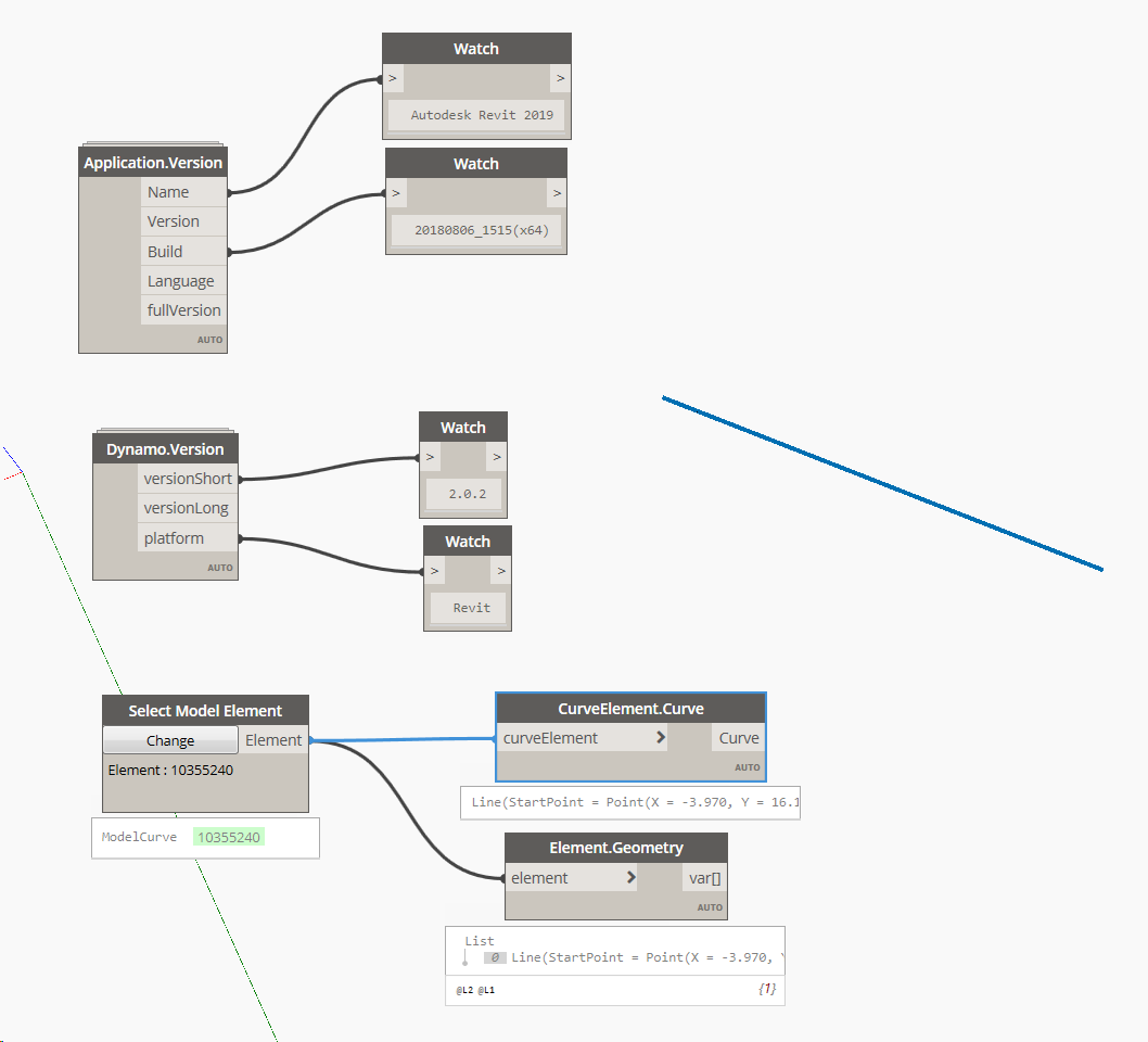

Seems that something has changed in 2019 as 2018 can get the curves no problem.
Trying to get the curves of Model Lines in Revit 2019 - error Autodesk.LibG.LibGPINVOKE

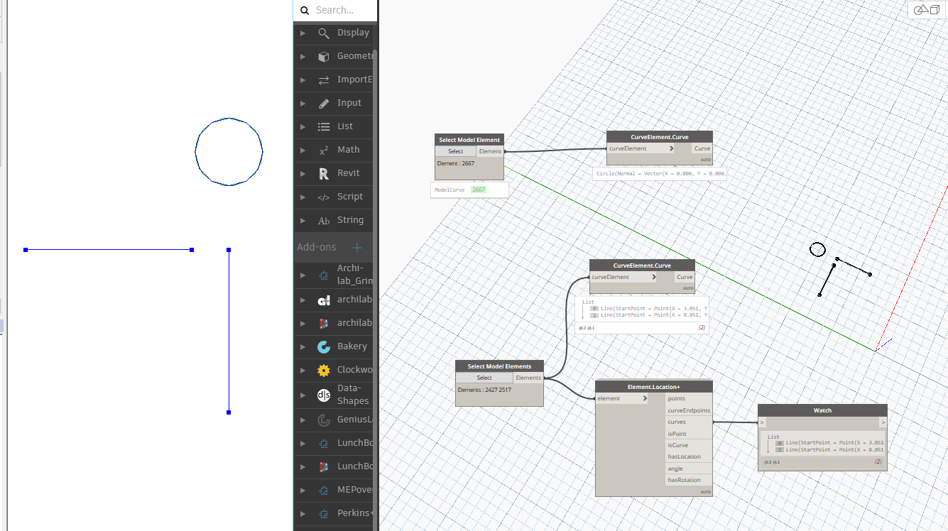

It works fine for me

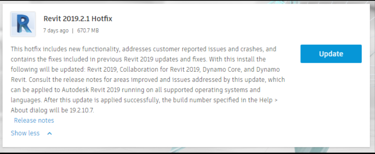

Hi @AdamHamilton
Try updating your revit 2019 version to 2019.2.1. It has got many fixes:
thanks guys the Dynamo to 2.0.2 fixed this issue but we will be testing the Revit 19.2.1 for firmwide deployment.
