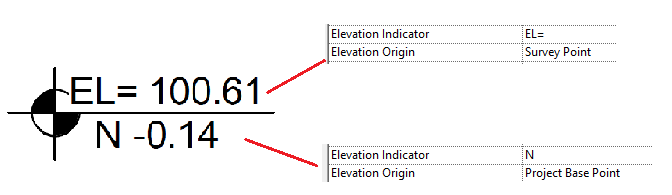

I would like to know , if is possible to have 1 spot elevation, but showing 2 Elevation Origin Reference (Survey Point+Project Base Point)

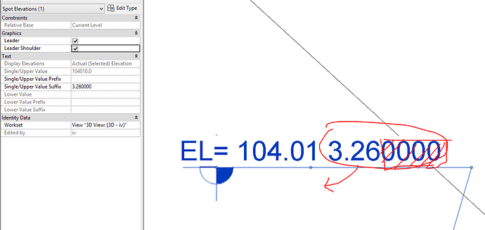

I’ve already try, without success:
1/ Adding a instances Suffix (as string)
But, I can’t move the position of the Suffix (instead right side…I need it Below)
2/ Unlock the Lower value (because is a “read-only” parameter) to write another value taking the Single/Upper Value as reference
3/ Adding an annotation family inside the spot elevation symbol.

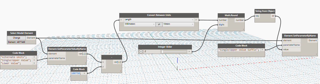

Hi, I have adapted myself by changing a little more of your dyn file.
Survey Point.dyn (15.5 KB)
Survey Point

Hi everyone,
I’m also interested by this spot elevation that show 2 elevation origins, oneabove the other.
I have tested the dyn file and works fine but still it’s not exatly what I’m also looking for…
The ddyn file give 2 elevation origins but one next to the other…
If somoeone has any clue on having the 2 informations like on the picture that sent veas87 would be great.

it’s not possible. i looking for answer same question.
