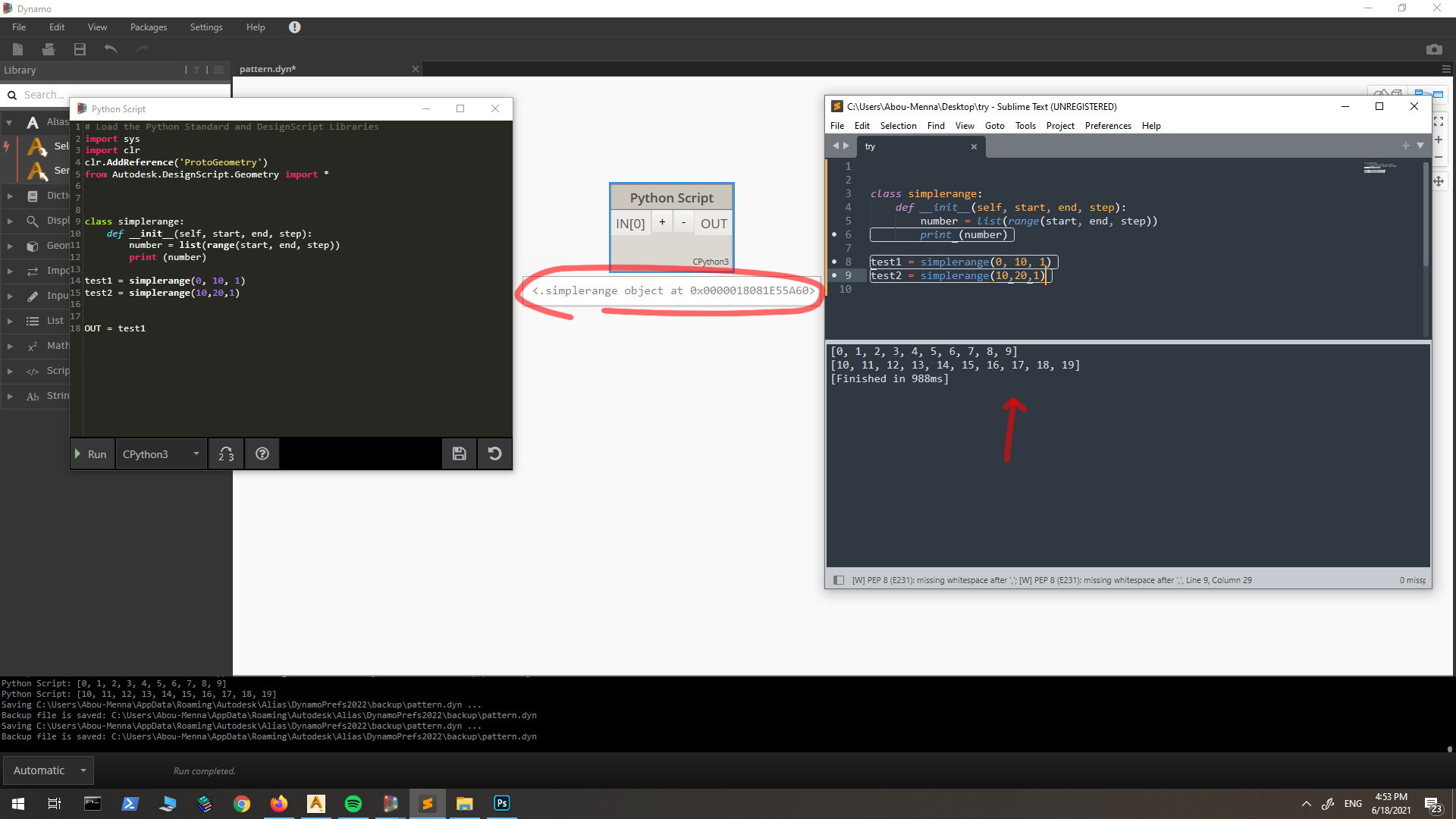

At that simple code, why python node does not return a list of numbers, Please have a look at the picture.
I’ve never created my own classes in python, but could that be the case? You’re defining a new class and it seems to be returning the class object. My question would be “Why does it need to be new class?” I realize this is probably a simplified example, but unless you’re using the class with another custom class it seems unnecessary.
Looking at this some more and I’m guessing you may be new to Python (or at least IronPython) as your syntax is a little off. Besides not needing to define a class for a new function, Python would actually use return instead of print since there really is no print function. You also don’t need to wrap your range in a list as it’s already considered one.

Agreed with @Nick_Boyts - try replacing your print (number) with return number

Thanks for reply , actually, I’m posting that code only for testing, apparently, there are several bugs regarding classes in python nodes.
Unfortunately, return number gives an error:
type error, init() should return none, not list
You’re returning the class itself not the output. I haven’t worked with classes much in dynamo, but I think you want to have some thing like ‘OUT = test1.Number’ to get the class member
you’re returning your class, not a list - as @jpeele said above.
you should do
self.number = list blah blah blah
then OUT=test.number to return the member.
