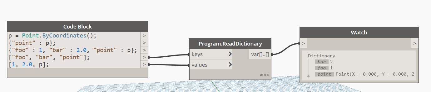

I implemented a simple class with one method that takes a Dictionary argument as follows.
public class Program
    static public Dictionary<string, object> ReadDictionary(Dictionary<string, object> dictionary)
        return dictionary;
My problem is that, if I pass a dictionary with mixed values including a Point like in the screenshot below, I will receive a “Warning: Object must implement IConvertible”, and the output dictionary does not include the point. Indeed, when I debugged the code and put a breakpoint on the line “return dictionary”, I can see that the input dictionary only contains 2 elements with keys “foo” and “bar”. What is my mistake here?

Thank you Aparajit and Michael. In the meantime I will separate the keys and values as follows.
static public Dictionary<string, object> ReadDictionary(List<string> keys, List<object> values)
    if(keys.Count != values.Count)
        throw new Exception("Must have the same size");
    Dictionary<string, object> dictionary = new Dictionary<string, object>();
    for(int i = 0; i < keys.Count; i++)
        dictionary.Add(keys[i], values[i]);
    return dictionary;
Many thanks Erik, that worked.

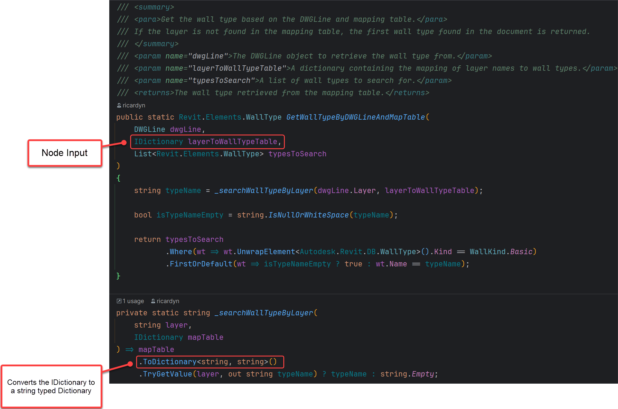

For the record, the IDictionary class in your code comes from System.Collections, instead of System.Collections.Generic.
The way to achieve that is.
Your Node Input must be an IDictionary.
Then, inside in your Node logic you need to convert the IDictionary to a string typed Dictionary.
This allow you to consume your input data as you wish.
See images below showing how I implement that.
Node Method
Generic extension method to convert IDictionary to the strong typed Dictionary
