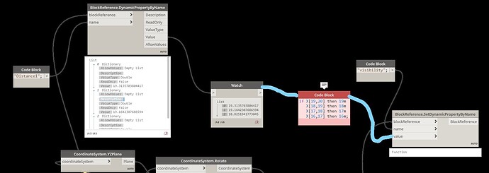

i have list of values and each value equals a parameter of visibilty
for ex list 0 =19,34
1 =20,22
2 =27,66
and if the value between 19<X<20 then =bananas, if value between 20<X<21 then =tomatos etc…
see below for more explanations

but i really need to use a formula like this IF x between [10,20] then = bananas
IF x between [20,30] then = tomatos
IF x between [10,20] then = chips etc…

@dr.hybride It’s failing because there are no indents in your Python code.
I would recommend you to go for the DesignScript approach as suggested by @jacob.small
If you still want to go the Python route you can do so as suggested below.
DesignScript
x<20 && x>=19?"Chocolate":
x<19 && x>=18?"Bananas":
x<18 && x>=17?"Chips":
"Check Value";
Python
out = []
for i in IN[0]:
	if 19 <= i < 20:
		out.append("Chocolate")
	elif 18 <= i < 19:
		out.append("Bananas")
	elif 17 <= i < 18:
		out.append("Chips")
	else:
		out.append("Check Value")
OUT = out
