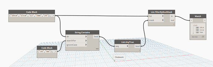

Here’s another way.

Maybe It can help you.
