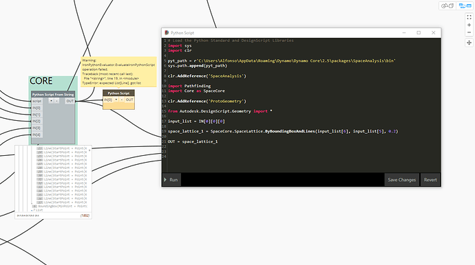

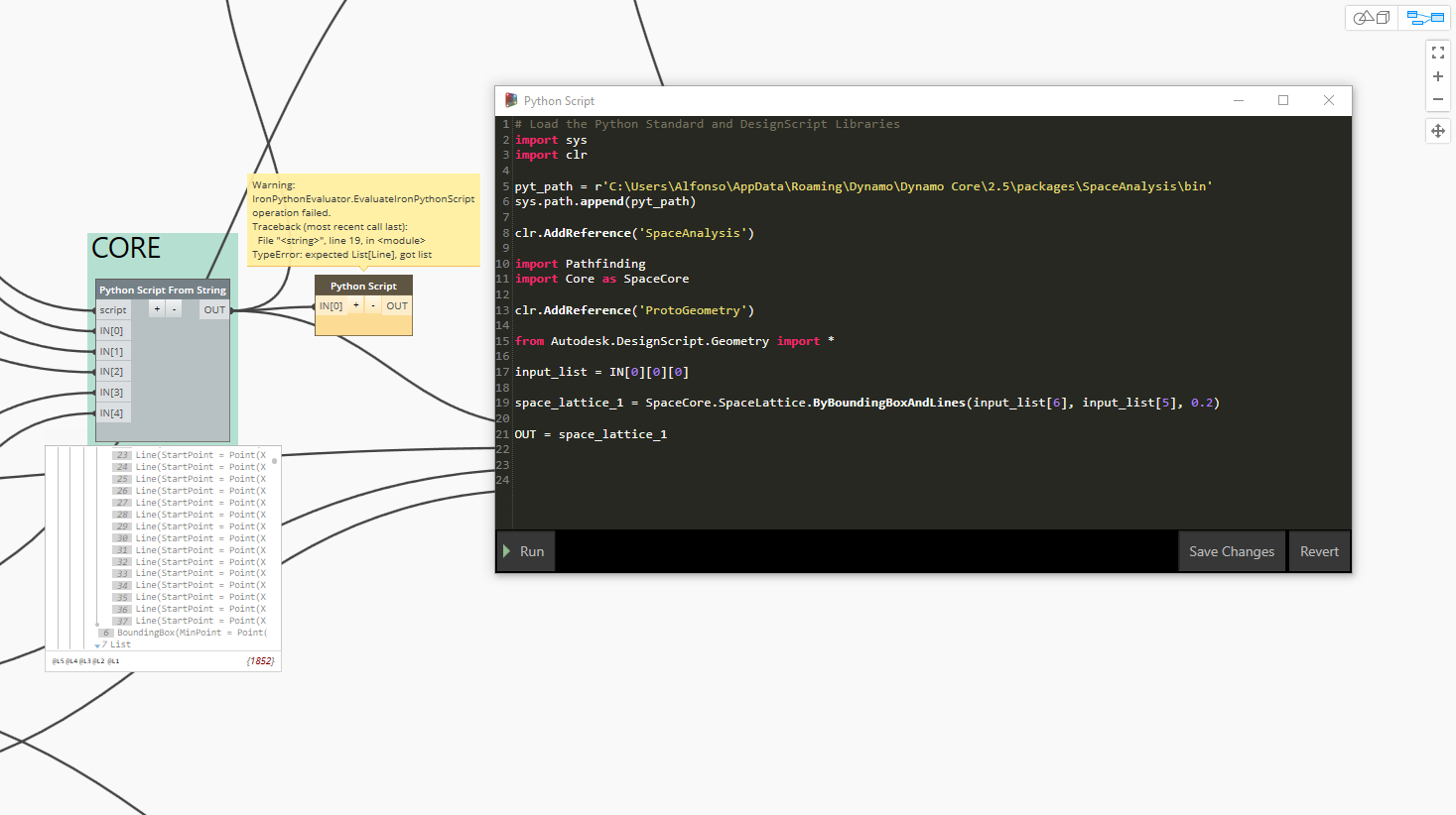

Hi EveryBody. I’m trying to use the SpaceAnalysis Package inside python. When I try to create a SpaceLattice this error comes:
TypeError: expected List[Line], got list.
input_list[5] is a list of exclusively lines, so I don’t understand it.
Any Ideas??
Thank you very much in advance!
