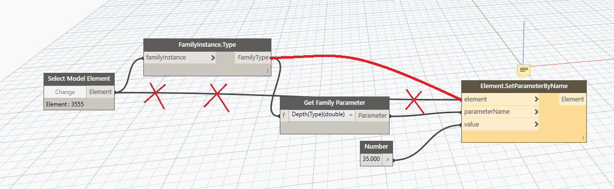

Hi Is this a bug? Warning: Element.SetParameterByName operation failed.
No parameter found by that name.
@Justin_Wright Connect family type to setparameter node not the element. Parameter is a type parameter.
@Justin_Wright
