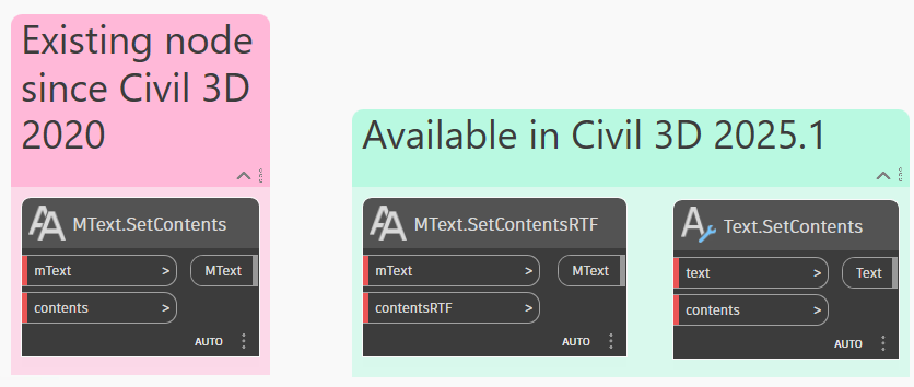

Hey folks,
Just wanted to highlight that Civil 3D 2025.1 includes a node for setting the contents of text objects. Combined with the core Dynamo nodes for String.ToUpper or String.ToLower, this task should be much easier now.
