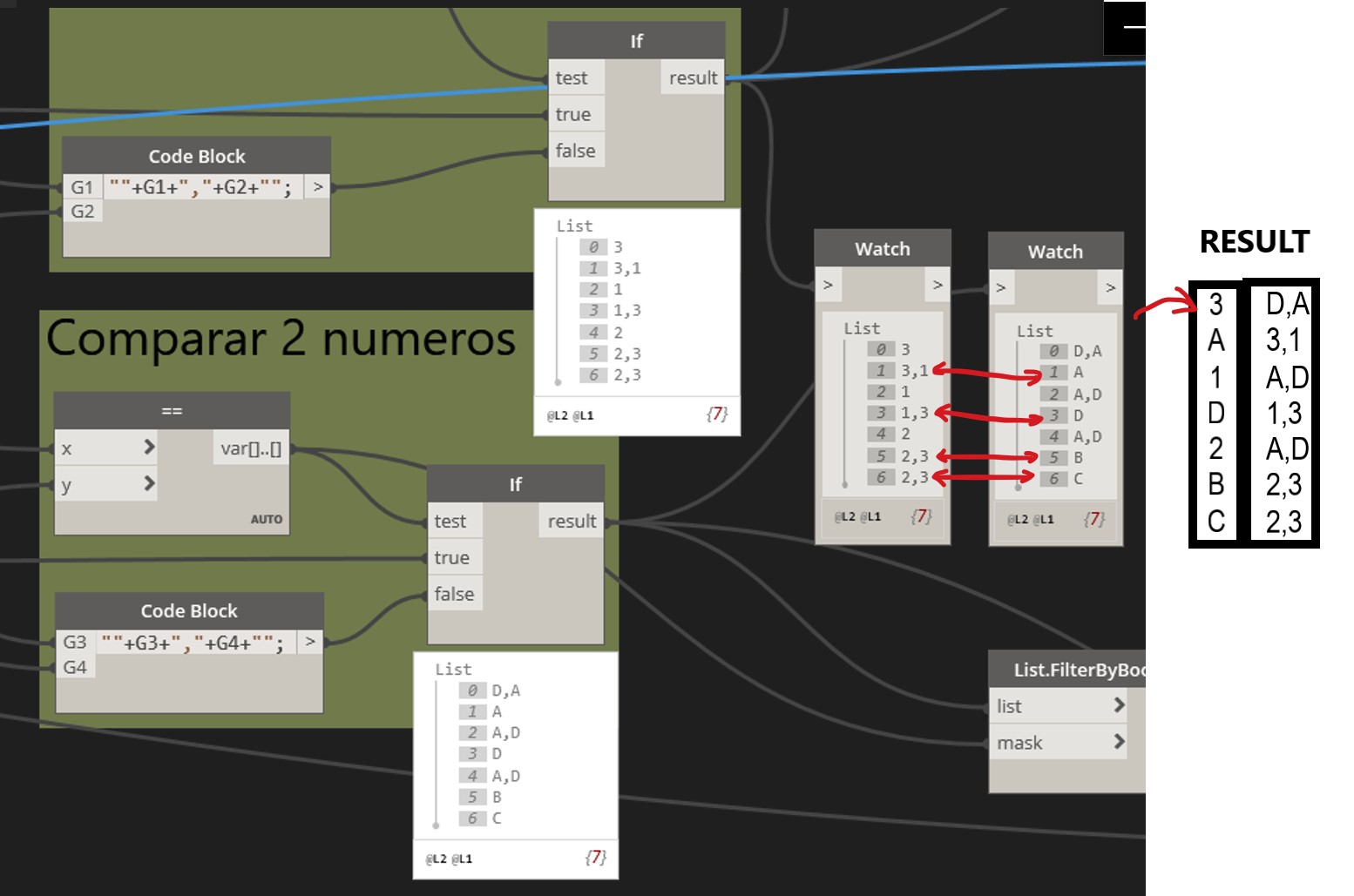

Good evening, please help, I need to exchange values ​​between these two lists, so that the numbers and letters are on the left and numbers and letters separated with a comma are on the right. Thanks for the help

hi
String.Contains(lstA,",")?lstB:lstA;

or
String.Contains(lstA,",")?lstB+lstA:lstA+lstB;

As @christian.stan suggested, String.Contains is the easiest way to handle this.
From your image it looks like you’re merging the lists in the result so just merge them for the conditional as well. If order doesn’t matter, then just join the two lists as-is. If order does matter, then use List.Transpose to get the indices paired together and then Flatten. From your combined list, List.FilterByBoolMask will return both lists as you want.
