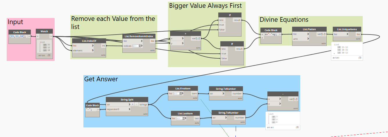

Hi @superfabi.krause,
this is quite a good coding challenge, but I am missing some restrictions.
Should you filter by Unique answer or unique equations (which can still give the same answer )?
you can do:
15-12 (as suggested), but also 12-15 = -3, this is a unique equation.
should the awnser always be positive? if not, you have more combi’s?
:roll_eyes:
This is the one you are exampling
this is when you always want the bigger value first
Hmm, @superfabi.krause mentions that you should not apply the function on the same value
say:
15-15
Which happens if you use cross-product. Also, now the same equation happens more then ones?
after that we can simply remove the 0…it will be easy I think…but I don’t know an exact expectation of @superfabi.krause

@superfabi.krause Another way using List.Permutations: Subtract.dyn (18.3 KB)
