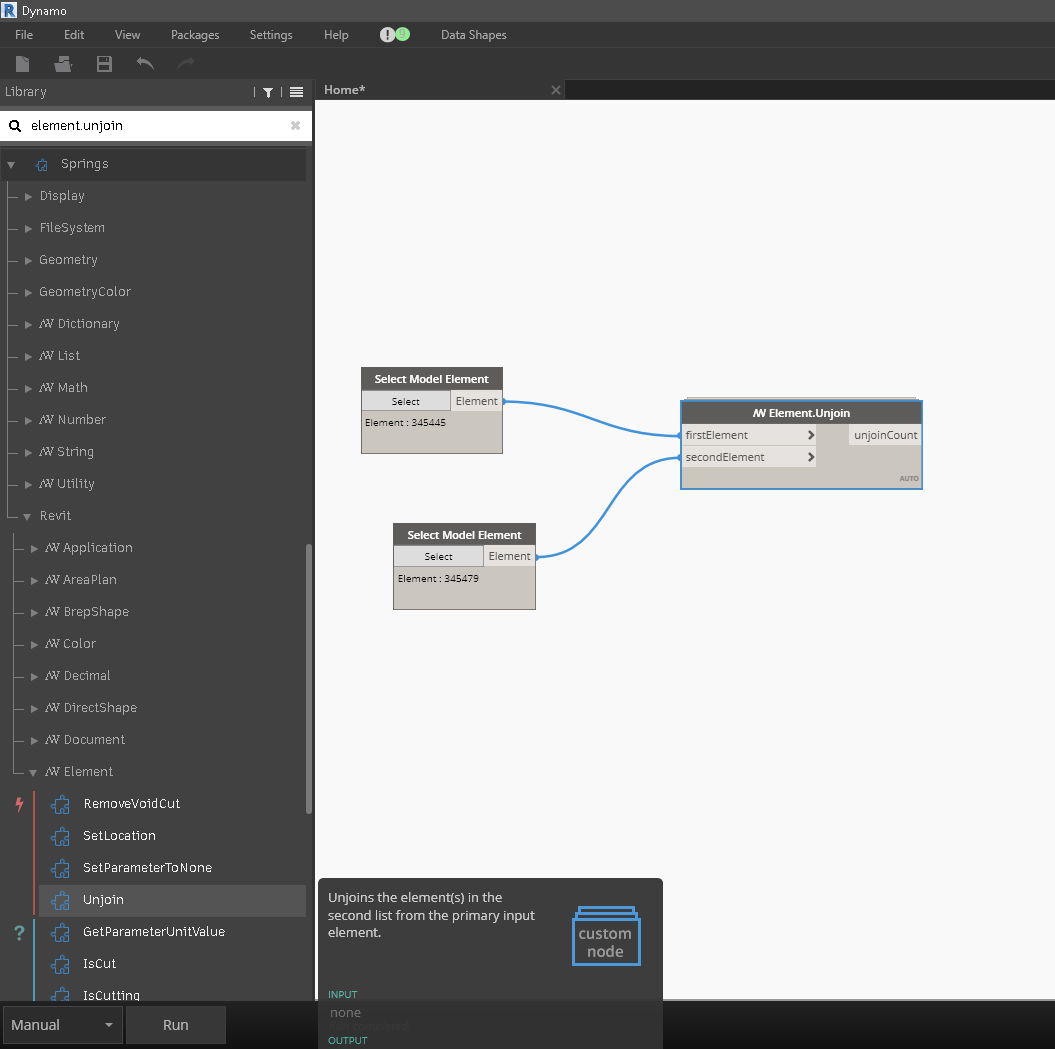

Hi @manishshilp21 and welcome, try to get it like so:

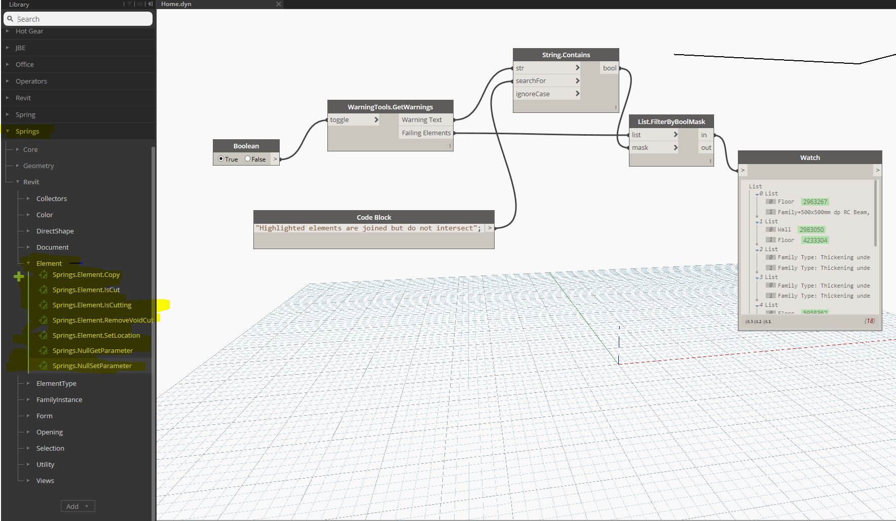

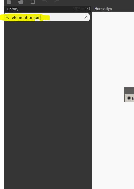

Thank you so much for your prompt reply. However I am not getting it, as I believe I am new and not have that much knowledge. Attaching the images.
Hello, try typing Unjoin case sensitive in the search module
Which version do you had install there, try to reinstall it and install the latest version
I think your package is outdated.
On the new one we see more “spring.” and it’s been replaced by a symbol that looks like “AV”
