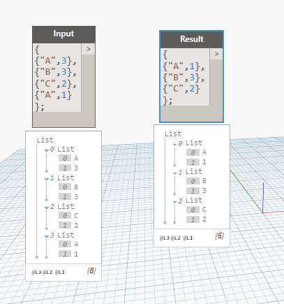

I have a list:
{{“A”,3},{“B”,3},{“C”,2},{“A”,1} };
Every letter has a paired numeric value (e.g. B =3 etc.)
I need to do the following:
  1. find if there are different values for the same letter in the list (e.g. A=1 and also A=3)
  2. compare the values and return mnimum value for that letter (e.g. A=1)
  3. create a new list without duplicates with all letters assigned to minimum values.
    {{“A”,1},{“B”,3},{“C”,2}};

Here’s a shorter option using “GroupByKey”
@Ilya_Kirichenko Another approach
groupAndSort.dyn (4.6 KB)
