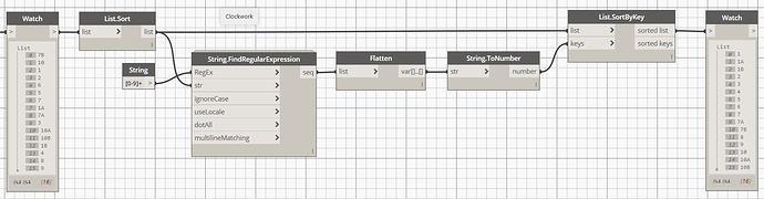

You need to sort them by letter then number.
Elements are sorted. The strings only serve to demonstrate that.
Note that the strings are parameters obtained from sorted elements.
The sorted list output port on the last SortByKey node in my graph gives you a list of sorted elements (You can flatten the list, if you want)
Sorry about that, yes your method did Elements. Thank you!
