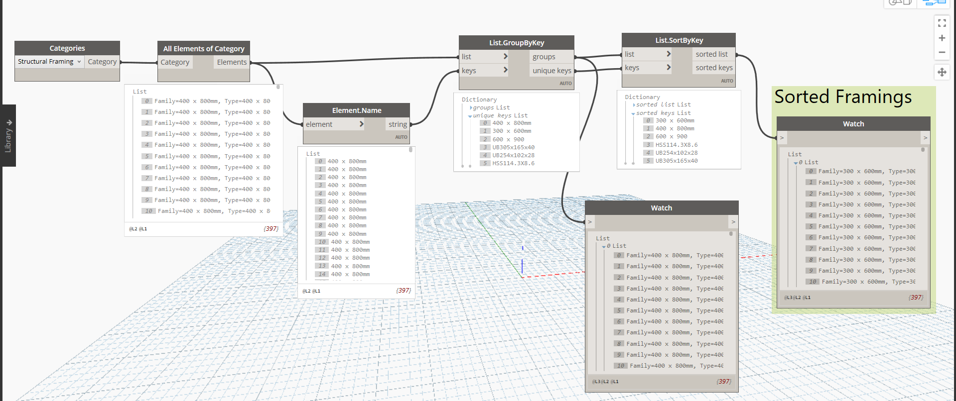

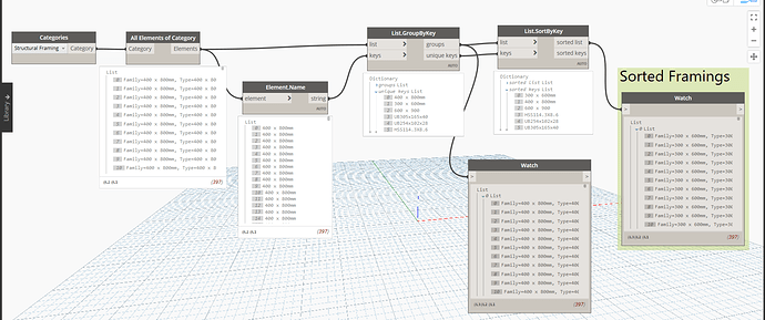

I’m trying to sort this list of structural framings by their type names, but the sorting is like CB1-CB10-CB11, I need it to be CB1-CB2,CB3, etc, Can anyone help? - I’m sure this is basic stuff but I just can’t figure it out.
