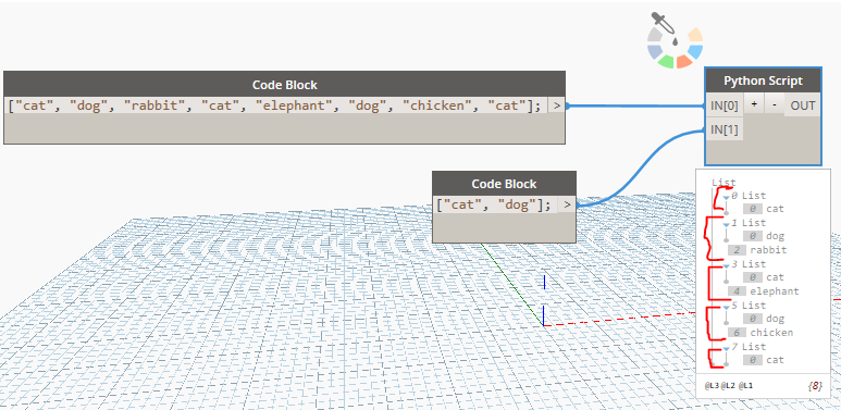

very close, I am expecting to slice the list when those strings appear, but the subgroup would be comprised between the string item found until the next found in the list, the subgroups would be what I marked in red. Many thanks

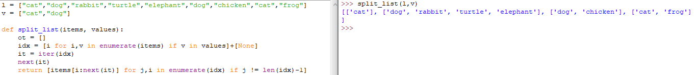

I don’t have Revit readily available, so here’s a screenshot in the stock Python shell:
