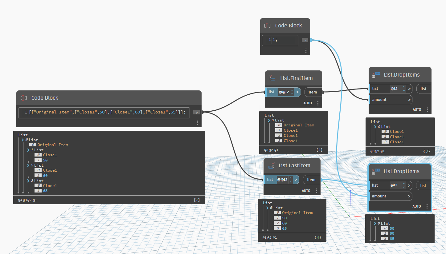

Can someone help me create a new list from this data structure that removes index 1. I would like to have lists with elements rather than multiple lists within lists.
Thank You
Thank You
I do not want to modify this list because I need the distances. I would like to create a new one using this node.
Likely an easy solution with a Zip function, or removing one. Can’t say without seeing the code.
For a node based solution: List.DropItems (to drop the first item), then List.FirstItem (to pull all the elements out of the sublists).
Certainly a more functional method in the hidden code though.
Yep, @jacob.small a visual below.

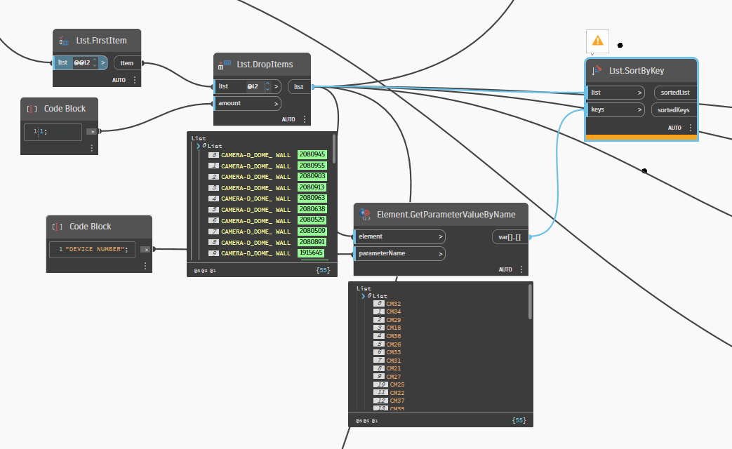

One last question regarding this code here. I was able to remove the distances from the list. Is there any way I can reorder the new list of elements based on a parameter value? Please see image below.
Thank You
Via nodes: List.SortByKey node.
SortByKey gives me an error
List.SortByKey operation failed. One or more input types are not matching. Lists as keys are not supported.
Thank You Sir!
