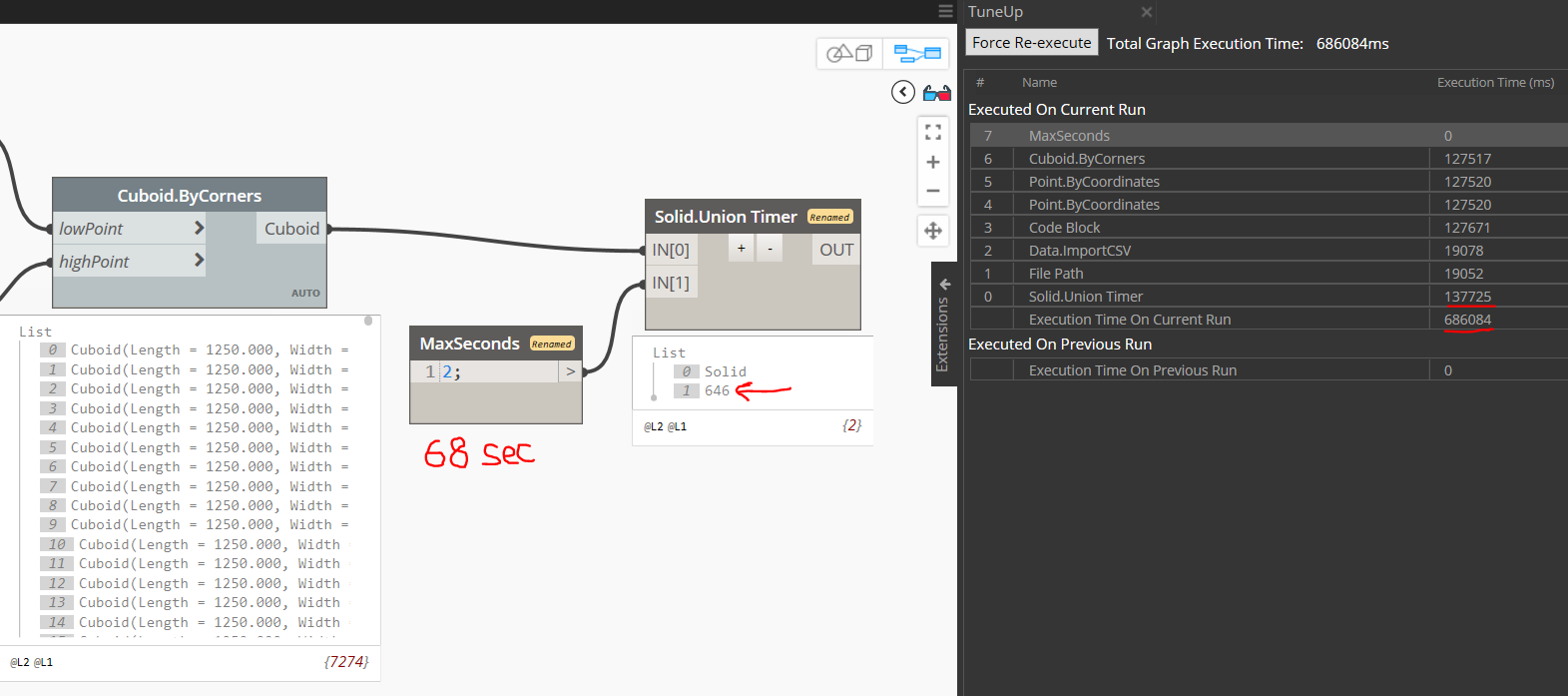

Although there have been some improvements with the below code to prevent the session from freezing, the script still does not adhere to the specified timer. It doesn’t matter if you enter 2 seconds or 10 seconds. The script may complete running in anywhere between 20 seconds to a couple of minutes.
TuneUp is also causing confusion up by showing about 10x more runtime. Instead of 68 seconds it shows 686 seconds (686084 ms).
