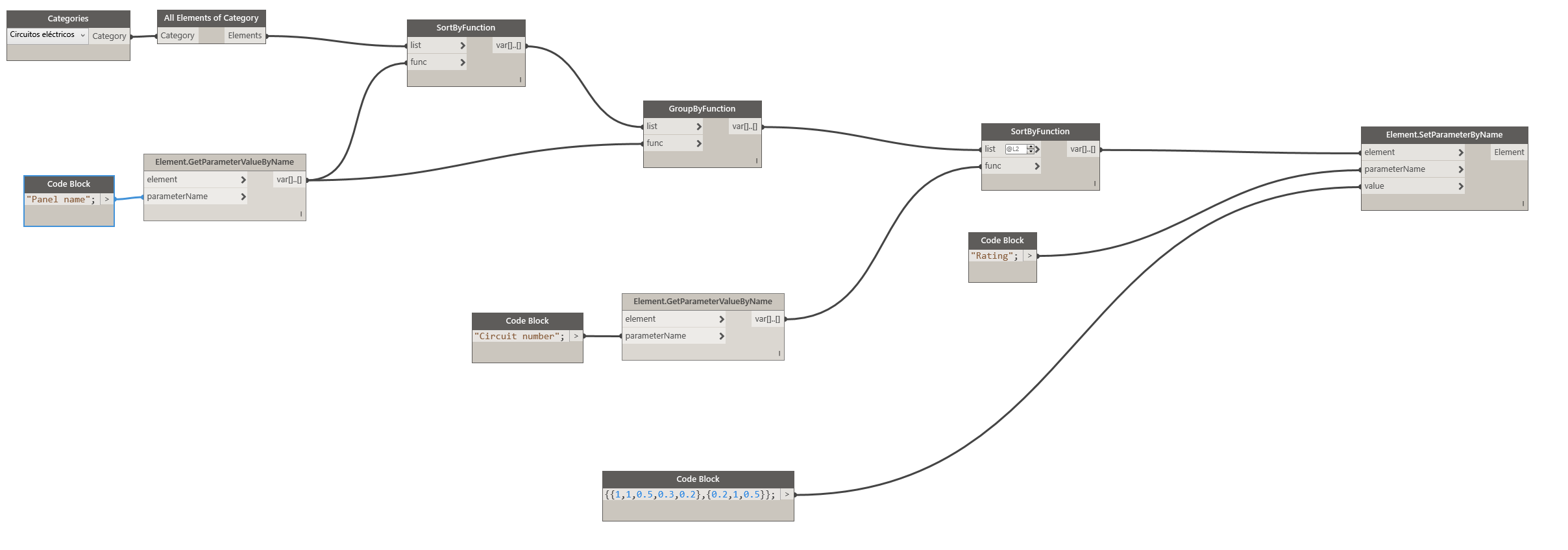

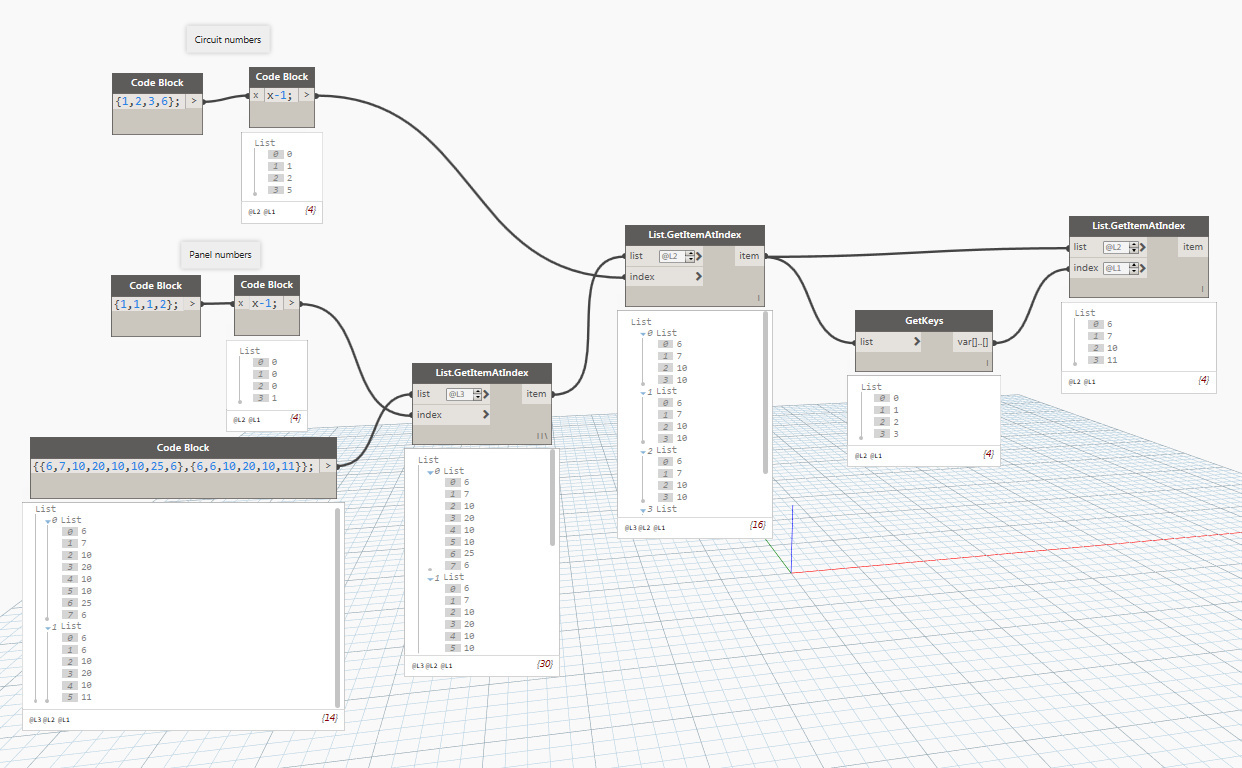

What I want to do is set the rating parameter for electric circuit but before that I want to make sure that It is properly set.
For example:
If Panel name of the electric Circuit is Panel 101 and the circuit number equals to 1 than set the rating parameter for this specific Electric Circuit to 6.
Get it? Thank You!!!
Thank you!!!
Solved my problem!
