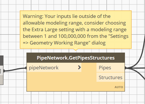

I created what i think is the same script as showing, but i am getting this error. Where would the “Settings => Geometry Working Range” be found. Thank you.

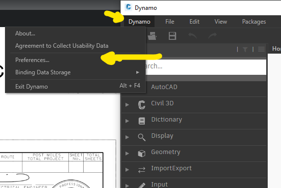

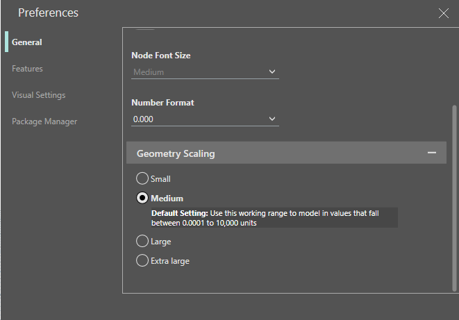

If you’re on the newest version, under Dynamo tab then preferences, then under general tab and then geometry scaling menu at the bottom
After changing Medium to large or extra large. it came error.
Standard setting in Civil 3D is to stay at medium range even if you get error message.
Quick point of clarity: This is a warning, not an error. Similar in that the user who rand the graph needs to review and may need to change something after doing a review, but a warning means ‘things still processed and might be as you’d expect’, while an error means ‘this couldn’t be completed and as such it’s unlikely you are going to like the result.’

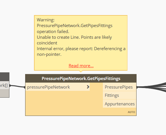

It’s not executing the comment. It was blocking process
In most (all?) cases geometry scaling warnings are a non-issue if left on medium. If it is failing there you may have another issue in your dataset as it’s an indication that the pipe in question has no length.
My bad, thanks for commenting @jacob.small
You are correct. I noticed, there was pressure pipe catalog missing. That’s why it came the error.
