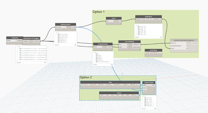

@viktor_kuzev I love the simplicity of your idea. It definitely achieves my goal, but unfortunately I would have to modify it on a by-project basis. The downside for my application is that the Levels have to be in a particular order or else it incorrectly names them.

In this image Option 1 represents a possible way to rename all levels based on their elevation.

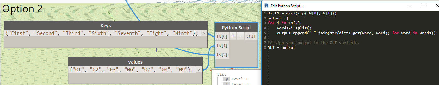

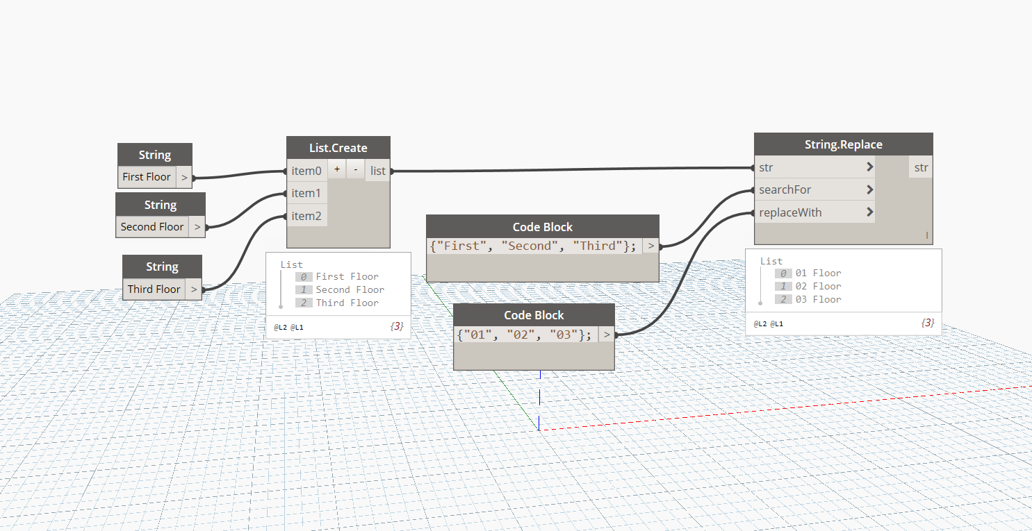

Option 2 Looks for a certain keyword and replaces it with a certain value.

But I find it simpler to use a Python for this:
