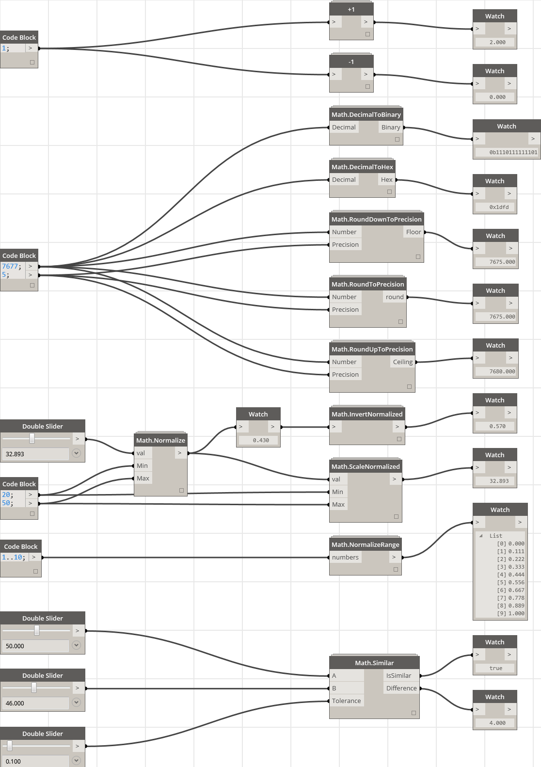

I have a couple of nodes in package Clockwork for rounding that can do exactly what you’re looking for.
Rows 3-5 in the screenshot below:
