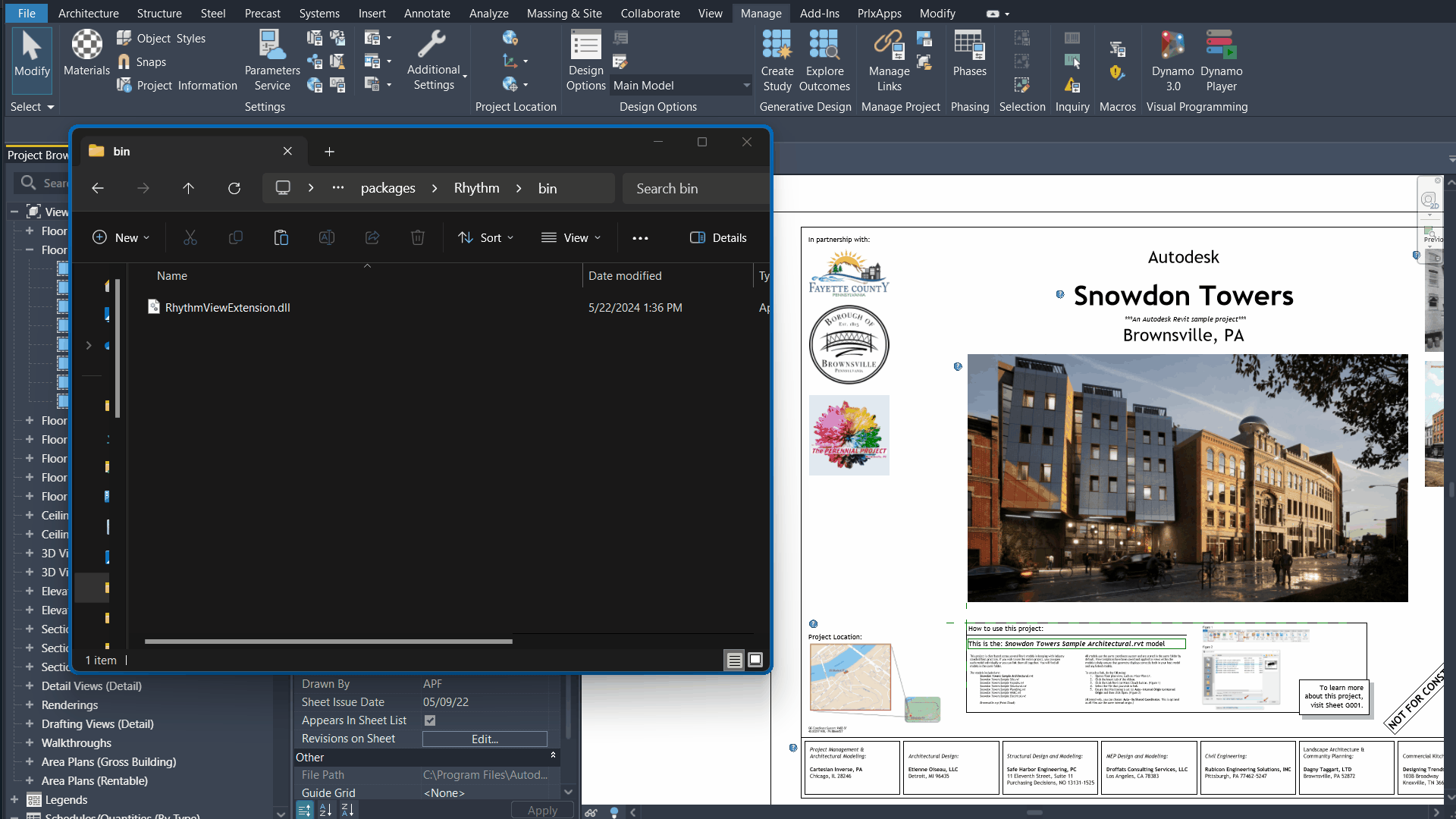

Rhythm now downloads the DLLs on the fly. This means every Dynamo user (since 2.0.x / Revit 2020) can download the latest version, and it just works.
This also means that I should (almost) never have to push a package manager update for Rhythm again. I just push updates to Git Hub now.
20240522-rhythmFromGithub
That should do it until the next thing is broken on Dynamo’s side, folks! :v:
