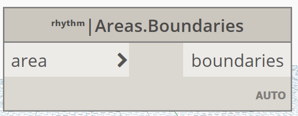

My preference would be to have the package name in the node title (or an an option to turn this display on)
I guess the only issue might be the text length in some cases i.e “BimorphNodes.Curve.RemoveDuplicates”

Data shapes has an option to prepend this information. I also added a view extension to Rhythm that does this upon node placement for Rhythm nodes in 2.0. :grin: image
o.k thanks John
you are one (probably way more than one) step ahead of me
lol, just wanted to make sure to share how I implemented similar functionality in Rhythm. :slight_smile:
