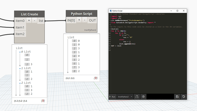

Hi everyone!
i am studying python, i want to replace none value by “0”, but the output is not same input structure
please help me!
thank!

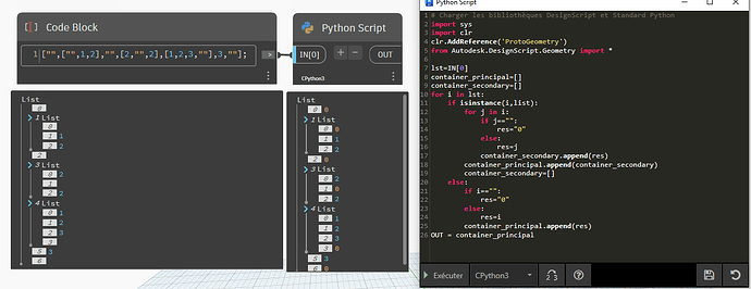

Hello
here is
lst=IN[0]
container_principal=[]
container_secondary=[]
for i in lst:
for j in i:
if j=="":
res="0"
else:
res=j
container_secondary.append(res)
container_principal.append(container_secondary)
OUT = container_principal

lst=IN[0]
for i in lst:
if isinstance(i,list):
for j in i:
if j=="":
res="0"
else:
res=j
else:
if i=="":
res="0"
else:
res=i
container_principal.append(res)
cordially
christian.stan
Thank you, Draxl_Andreas
Thank you christian.stan, it works
