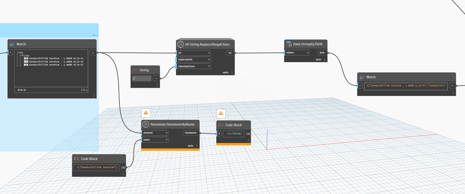

Hello everyone!
I have the same problem. I have a list of the thermal conductivities of the individual layers of a masonry. To export them in JSON format, I would like to remove all text parts except the number, to go from: “Thermal conductivity: 1.000 W/(mK)” to only “1.000”. I also searched in other topics of the forum but I did not find a code that suits my case. Can you help me?
Thank you!

Hello
cordially
christian.stan
Thank you, have a nice day!
