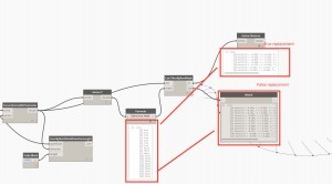

The above methods might not work for very extreme cases. You might want to consider looking into a solution based on this for those cases:

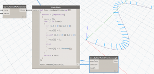

@Dimitar - my solution is based on the assumption that the inconsistency in direction occurs at the points where the Z axis is reversed.
It worked in all cases, I’ve tried. I’ve attached a Design Script version of the earlier file. Try it out when you have some time and see if it works.

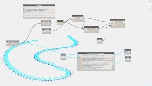

Just as food for thought, I’ve tried both and have found a case where yours doesn’t work Vikram but Dimitar’s does. I’ve used a spline (Vikrams highlighted - Dimitars not).
As attached:
Normals
:frowning:
So, Dimitar was right after all :slight_smile:
