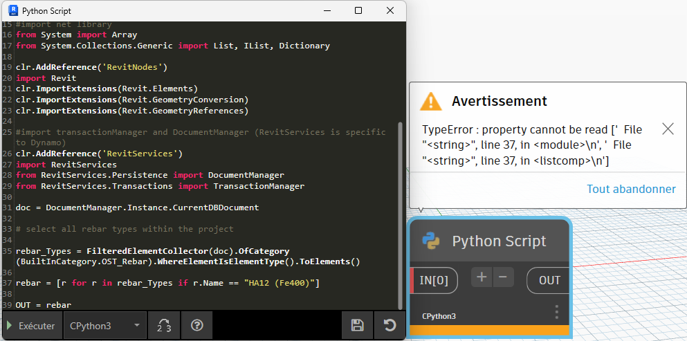

Hi All,
I’m encountering an issue reading the Rebar type names from the collected Rebar types and selecting the one I’m looking for. I tried accessing the Name property using two different syntaxes: RebarType.Name or Element.Name.GetValue(RebarType), but neither works. I’m getting the following errors according the used syntax:
I also tried collecting rebar types by their Ids and then getting the elements, but I still get the same errors
Otherwise, either syntax works correctly in the Revit Python Shell as shown below
Here the two codes:
Syntax: RebarType.Name

# select all rebar types within the project
rebar_Types = FilteredElementCollector(doc).OfCategory(BuiltInCategory.OST_Rebar).WhereElementIsElementType().ToElements()
rebar = [r for r in rebar_Types if r.Name == "HA12 (Fe400)"]
OUT = rebar

hi
rebar = [r for r in rebar_Types if r.get_Name() == "HA12 (Fe400)"]
You will have much more information here
cordially
christian.stan
