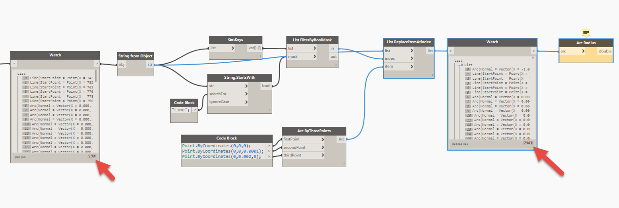

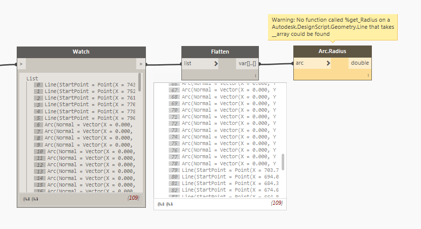

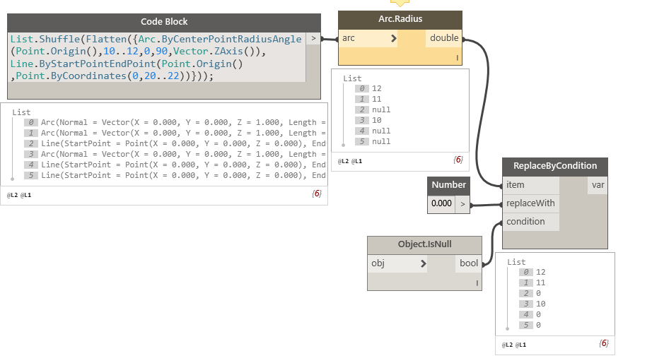

I wish to get the Radii from a list. The list consists Arcs and Lines, which makes it difficult because it wont replace the Lines with a Null.
How should I approach that?
Thank you for your help!
My current approach is to replace the lines with very small arcs, but I am stuck with the hierarchy. I have now 2943 elements and would like to keep my original 109. There must be somewhere a mistake with the levels.
Every line/arc represents a panel and I wish to export a rationalization of those panels to an excel sheet.
One part of the rationalization is the radii. So I wish to get a radius for all panels.
The lines should show a radius of 0 just like shown in the first picture.
I hope this clarifies the issue.

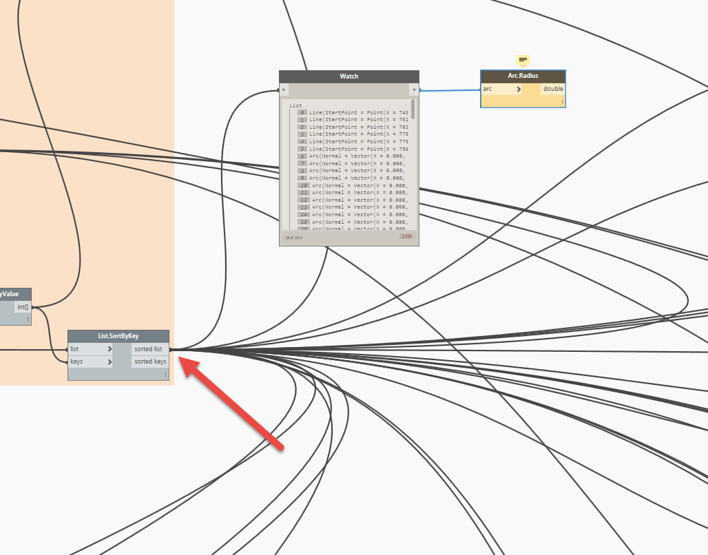

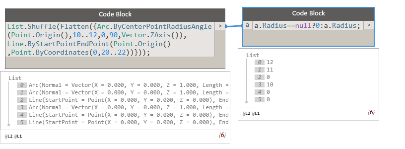

Thank you Vikram,
your code works well and it would work for me too. I guess the problem is that the Arcs and Lines are coming from a List.SortByKey. This node is causing the issues and I might have to find a different approach for calculating the radii.
