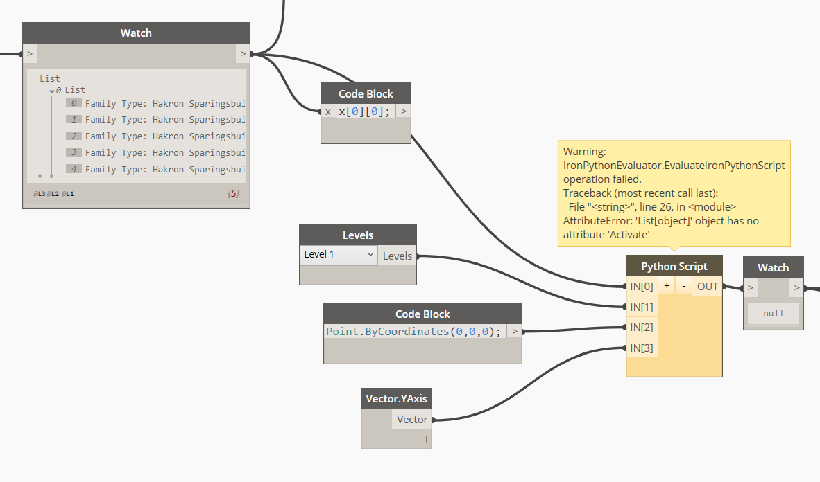

Python Script : AttributeError: List[object]
Trying to feed a List in a Python Script. For one item the code will run. But not with a List.
The Script is for Placing Elements on Level

out =
symbol.Activate()
reference = Reference(refPlane)
new = doc.Create.NewFamilyInstance(reference,location.ToXyz(),referenceDirection.ToXyz(),symbol)
#Assign your output to the OUT variable.
OUT = new
This is because you need to iterate over the items within the inputted list via a for loop. Some examples can be found within the below link, though note that it is your symbols that you need to iterate over.
https://www.w3schools.com/python/python_for_loops.asp
Check this…Python control flow statements
