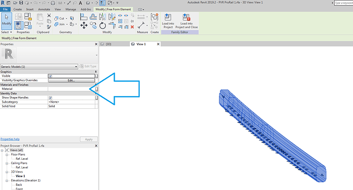

Here’s some ‘proof’ that it worked:
screenshot before running (inside family editor
after running:
