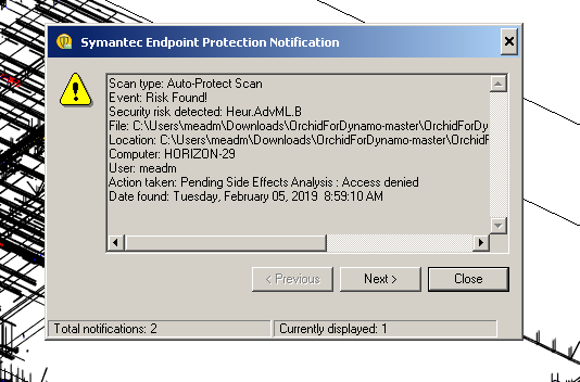

Ok, follow up to my follow up: The real reason I couldnt install the Orchid package was that it is blocked by my IT department. Is there anyway you can just make it so you can install it via the package download in dynamo? The fact that I am trying to copy an exe is apparently freaking out my IT department. Thanks

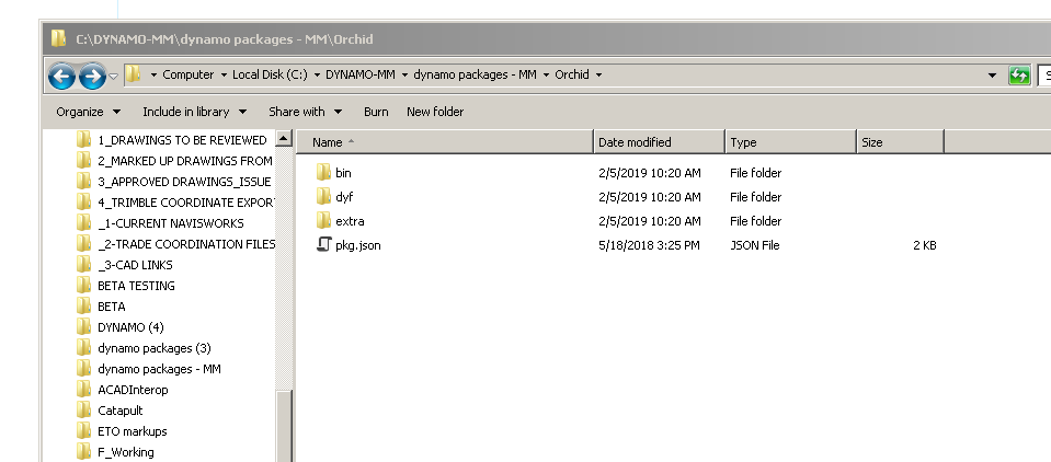

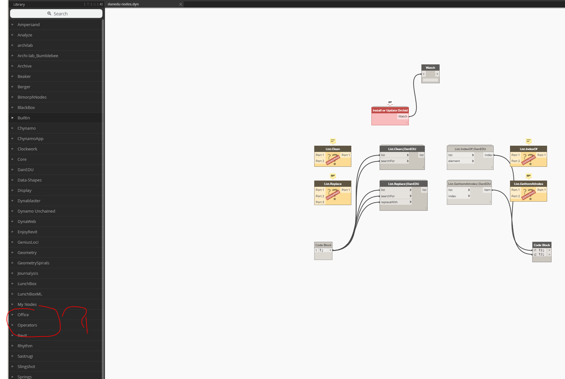

Ok, I dont know what I am doing wrong but every time I try to do that the orchid package somehow gets removed from dynamo and there is no sign of the original install node either. please advise.
Yes it does.

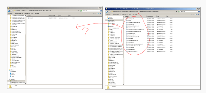

I notice however that when I have revit closed, and I copy the folder to my package location, it originally has all these files in the bin folder. (right) But after I then open dynamo again, somehow they all get removed (left). So something is happening behind the scenes that I dont understand and screwing everything up.
Well what do these exe files do exactly? If I run them, are they supposed to set up orchid for me or what are they for? Do i need to tell IT to allow them? Please advise. Thanks
