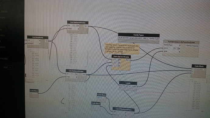

Hello everyone,
Please help me to correct the issue.
Thanks

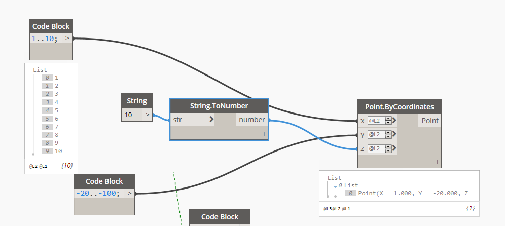

What is the error that you are getting at Point.ByCoordinates?
Maybe your inputs are strings, you need to convert them to Numbers
