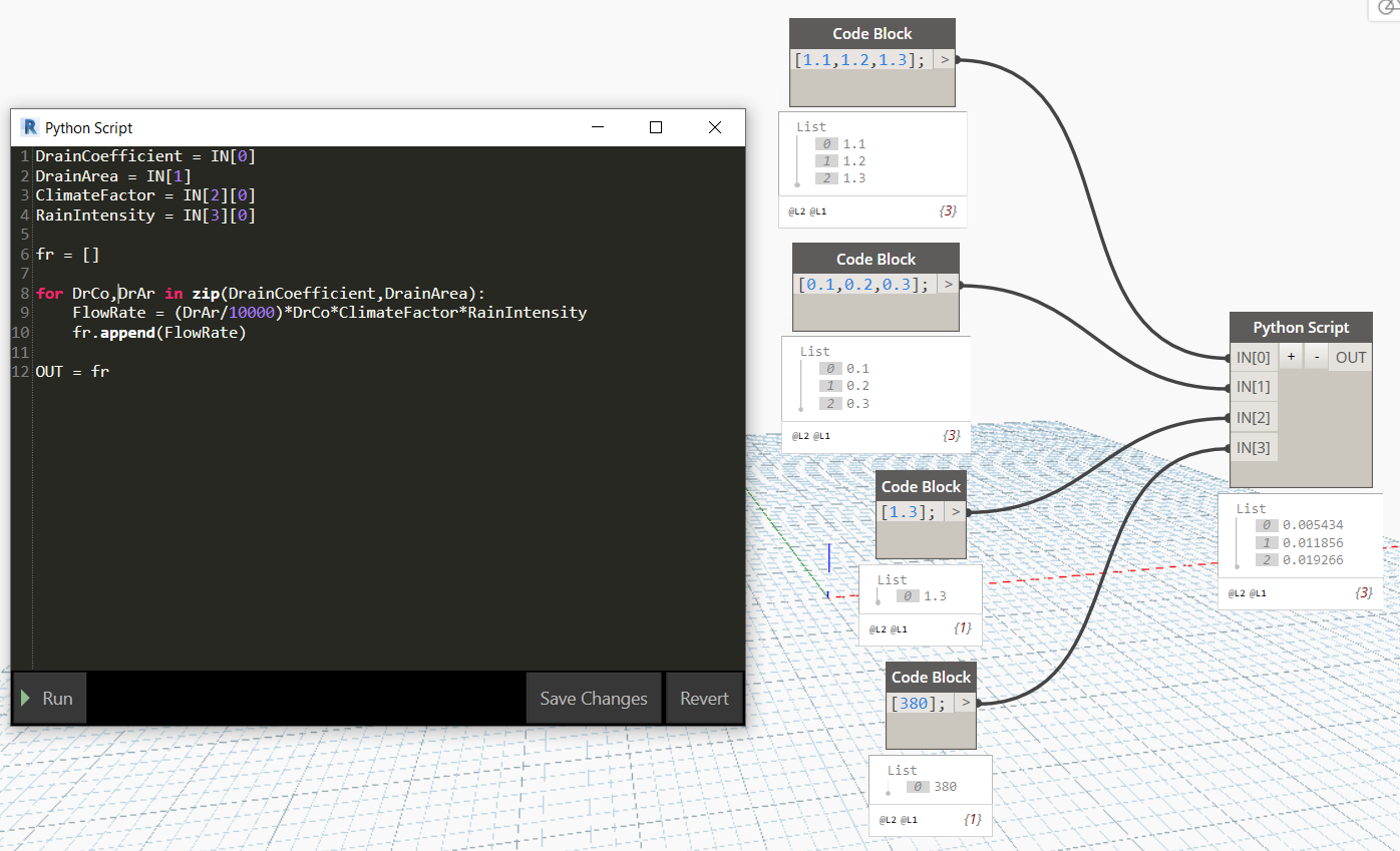

Can you help me solve this calculation?
Erro I get now:
Remove the indent on line 17
@Arun_Prakash Also the formula has not been defined correctly.
Try:
for i in DrainCoefficient:
x = ((i/10000)*ClimateFactor*RainIntensity)
fr.append(x)
@AmolShah I’m learning a lot from you
My bad, I didn’t see we were supplying a list.
Getting the item at index 0 from both of those lists seem to solve the issue
OR
Cool
@AmolShah Thanks a lot brother, it worked perfectly, I have learnt so much both yesterday and today
