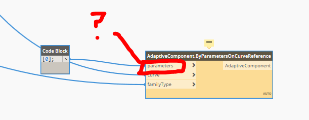

What does ‘parameters on the curve’, mean?
Try multiple values
(they all have to be between 0 and 1)
Does that work?
-Just a guess-
How would that look, i.e.
[0,1] or [0&1]?
Dont think you need brackets here just 0…1
If l have 25 curves, would it be 0…24?
I have tried 0…1 and it did not work.
Dont know what you try to do…but 0 is the startpoint and 1 is your endpoint and only 2 dots between 0 and 1…sorry see now i had made 3 dots
I did 2 dots. However no joy.
you see its very difficult to see, so long you dont share the whole graph…so everything is just guess…good luck
Try 0…1…#4
Hi Marcel…its a little bit funny when we type in 2 dots its actuelly show 3 in the image
Must be the bread crumbs in my keyboard i think
Hehe
Could be that you need to extract the curve from the line you have now
Flatten the output from “Framing from Selected topo boundary”.
