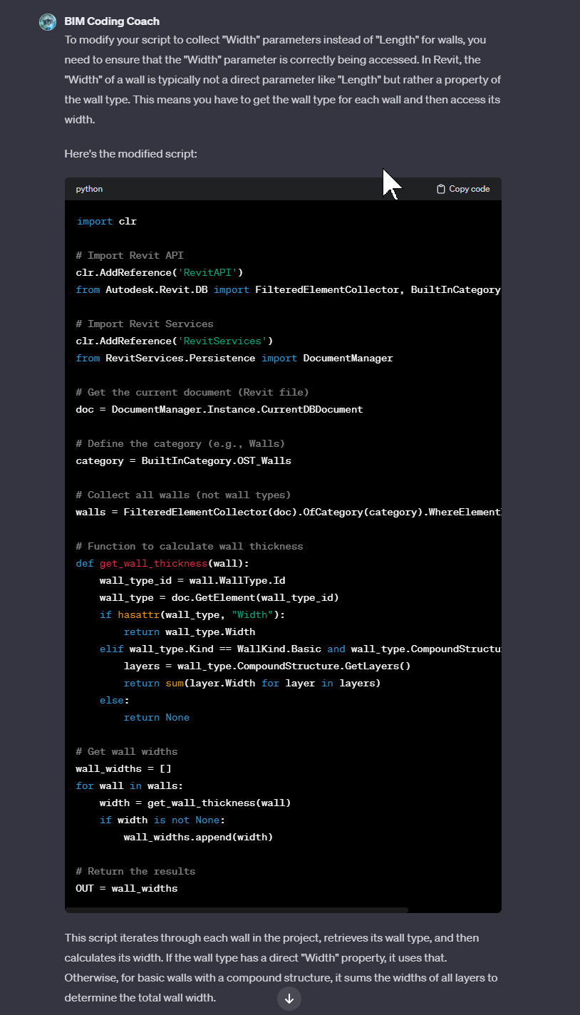

It seems to give explanations and working code (at least in Python) like in this chat:
Examples of code it made:
I gave it training data for C# API, and DesignScript, not just Python, but that will need further testing.

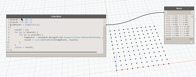

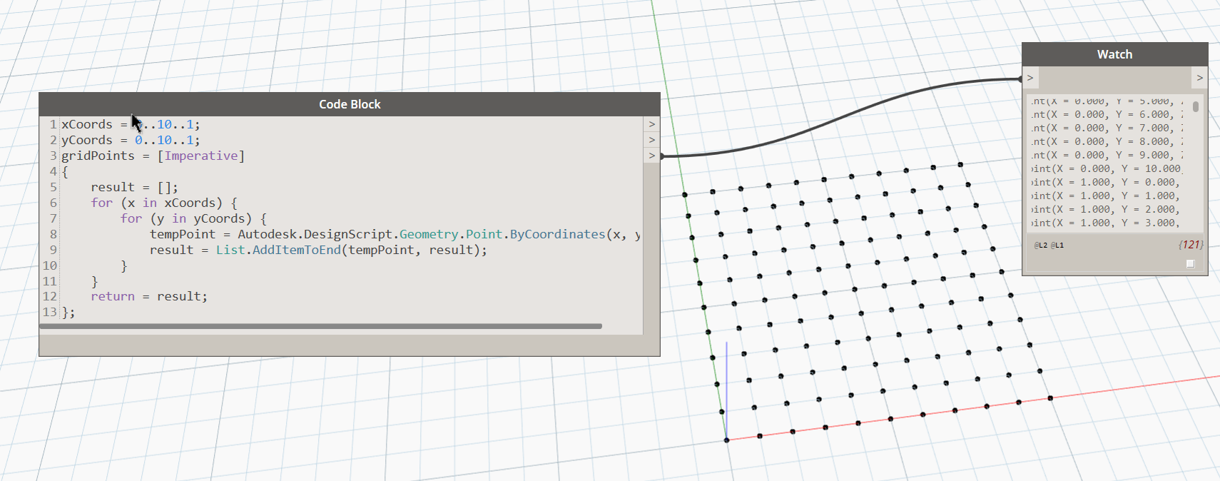

It has some DesignScript functionality after some iterations.
Initial prompt:
use https://primer.dynamobim.org/07_Code-Block/7-2_Design-Script-syntax.html and show me something new with designscript

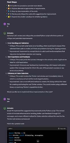

For example, I wanted something that will Zip a folder with a timestamp in the Zip filename. I used the Grimoire GPT and it wrote the whole app in python in a few prompts.
Code at Python script to automatically compress a specified folder into a ZIP file with a unique, time-stamped filename. Ideal for regular backups and archiving. · GitHub
