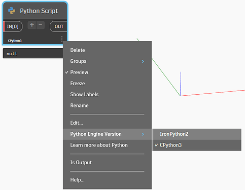

Good morning. I have been using your Python Script in my Revit 2022 project. however, I am unable to run the graph in 2024. I got this message…
I am not familiar with Python so any help would be extremely appreciated.
Thank you :slight_smile:
Where the 3 dots on the python node are, press it and change the engine to ironpython2 maybe?
Hi pyXam, i tried all Python engine versions and I get the same warning. Thanks for the suggestion, but unfortunately it didn’t work.
Hi @hanyiwamura ,
here is the updated code
