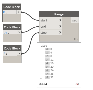

Newbie question: Is it possible to create a range of numbers like in the title? Example:
First: 0, Last: 32, Steps: 7 would give: 0,4,8,12,16,20,24,28,32.

Try this:

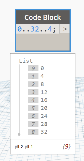

or this
