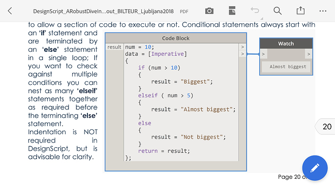

Looks as if you still need to append the results onto the list before you return it. Check out this documentation from @solamour’s BiLT class last year.
Also, you don’t need to go imperative in this case - just process the list as you normally would.
Thanks for the link, just got down to here…
Edit: Just for the record I did finish it, thanks @solamour great resource!

I tried to mimic the code in the document, but it doesn’t create any point.
  1. your assign statement doesn’t make sense - you are assigning a point to a list.
  2. you might be hitting a bug with fully qualified functions in imperative blocks.
  3. when possible - avoid imperative. It’s simply not as robust as the rest of the language, as very few nodes compile to it.
  4. hook up a watch node to see what the output is.
