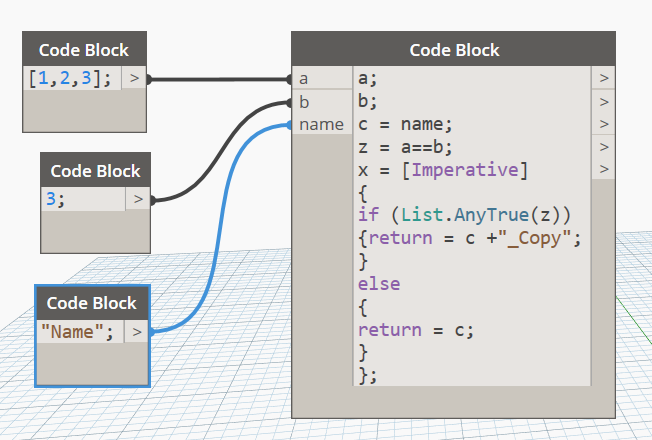

I would like to know if i can Loop in a codeblock so that a name always gets a “_copy” suffix if it is in use, for an infinite amount.
Here is how i can do it for 3 “levels” by putting 3 codeblocks together.
Happy about any advice :slight_smile:

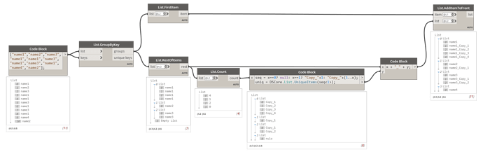

Assuming that you have the repeated names in the Element.Name node. Would this help somehow?
seq = x==0? null: x==1? "Copy_"+1: "Copy_"+(1..x);
uniq = DSCore.List.UniqueItems(seq<1>);
or
lst_groups = DSCore.List.GroupByKey(x,x);
groups = Dictionary.ValueAtKey(lst_groups, "groups");
rest_itms = DSCore.List.RestOfItems(groups<1>);
count = DSCore.List.Count(rest_itms<1>);
suffix = count==0? null: count==1? "Copy_"+1: "Copy_"+(1..count);
appended  = rest_itms + "_" + DSCore.List.UniqueItems(suffix<1>);
first_itms = DSCore.List.FirstItem(groups<1>);
lst_names = DSCore.List.AddItemToFront(first_itms<1>,appended<1>);
