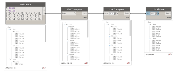

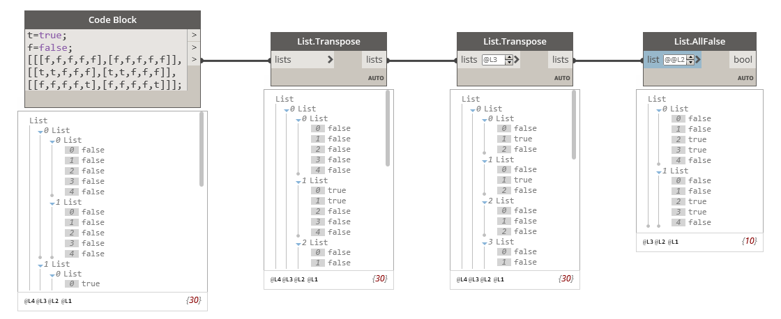

Greeting. I am working on a task that need to filter from 3 lists of data.
The 3 lists of data are same in structure while contains different boolean results. What I try is I would like to combine the boolean, and changes the results into “True” if all the boolean are “False” in those 3 lists.
Below as a example
What I want is to generate results as:
It would be great if anyone have the solution
Hi @TCKEAHY !
Is that what you are looking for ?

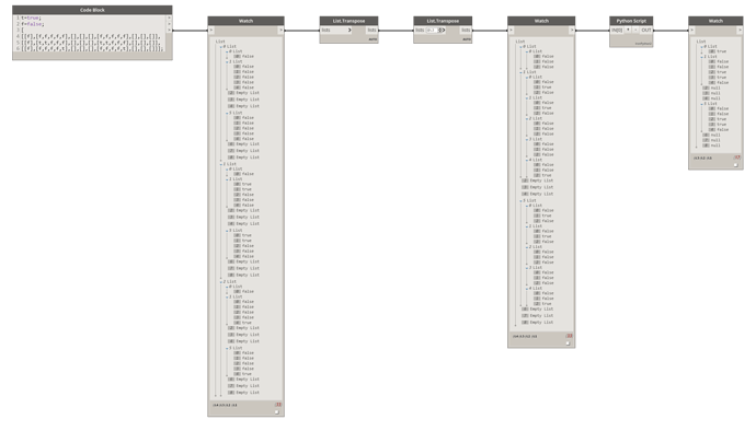

But there is a issue raised: after I use “list.CountTrue” or “List.AllFalse”, the last part of Empty List is not counted. As I need the correct number ordering, is there any way to reserve those parts in list?
@TCKEAHY Try this Python solution:
OUT = [[not any(lst) for lst in lsts] if lsts else None for lsts in IN[0]]
