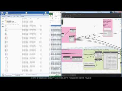

Here is how to rename files:
Connect the old file names (incuding the path) in “path” and the new file names in “newPath”

I find this:
I ask for the dyn to battlebim, i think he has the solution, is a different approach but it’s watt i’m looking for
