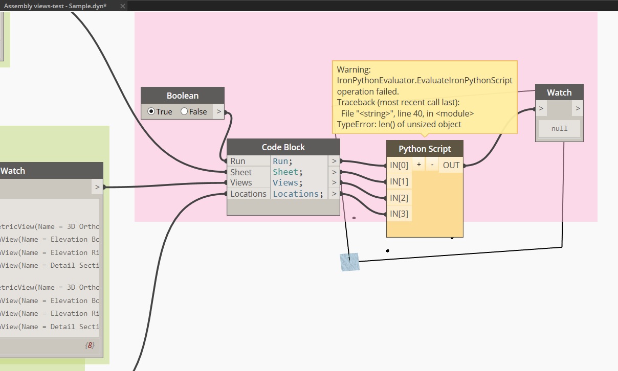

That probably means it was successful because I messed up in the code on the output. Use this instead:

That’s what I thought. At line 45, the script does a check if you can add a view to the sheet. If you can, it does. The last code I posted will say you can’t if it says you can’t.
That is probably because you are using only one view as an input in a list, so instead of a list of list, it is just a list. Either make sure each sublist in views and locations is a list or you will have to change the python code to work using it.
