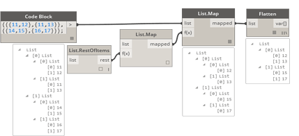

Here’s what i get.
After the second List.map it’s begin to look like what i’m searching for but the flatten didn’t seems to work as yours.
Not sure what i’m missing there…
Flatten seems to work as expected in 0.8.2 too.
Not sure what the problem is.
If you are in Manual, maybe you didn’t Run after adding/altering the Flatten node :slight_smile:
