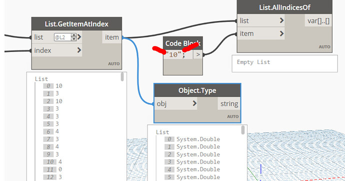

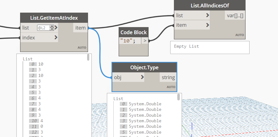

Can someone tell me why i got empty list here? Is it the reason the form of the number? how can i fix it?
Remove “” from 10 so you dont feed in string
i have tried with that but still empty list
Try to play with the levels, it looks like a level issue
also tried with all level 1,2,3
Theoretically should it works like that but not… For me the object.type is System.double…
have tried but stil empty list

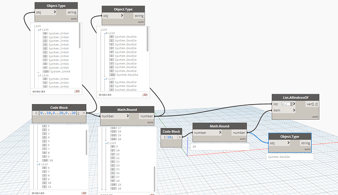

I think List.AllIndicesOf requires a hard pairing of data types, meaning you need either integer on both sides (list and item) or doubles on both sides, that is why @sovitek is using the math round, try his solution as it should work
