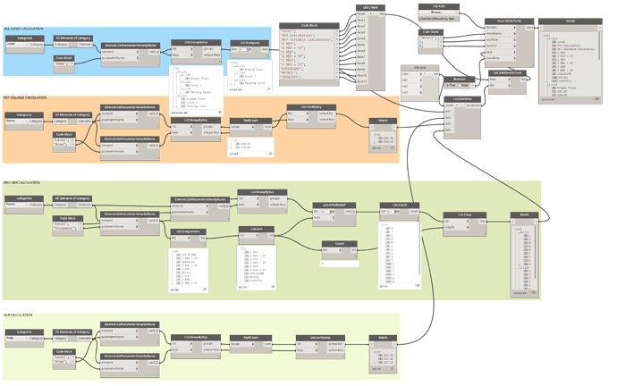

Hello, this is hard to tell without any graph, but if you make use of custom packages, some ReplaceNull nodes in Clockwork or DanEDU Dynamo could possibly help…
The graph below seems extensive but is structured so values are listed by level.
I have introduced (in blue) a list of all “Levels” as a starting point to become the way everything else is sorted regardless if values exist at that level or not. It might not be useful but this is where I am at.
The values I am after are in the orange, green and yellow boxes. These list just fine once exported to excel however, as my previous post raises, when I add a level without all these values available on that level it throws out the whole final list.
Hope this makes sense.

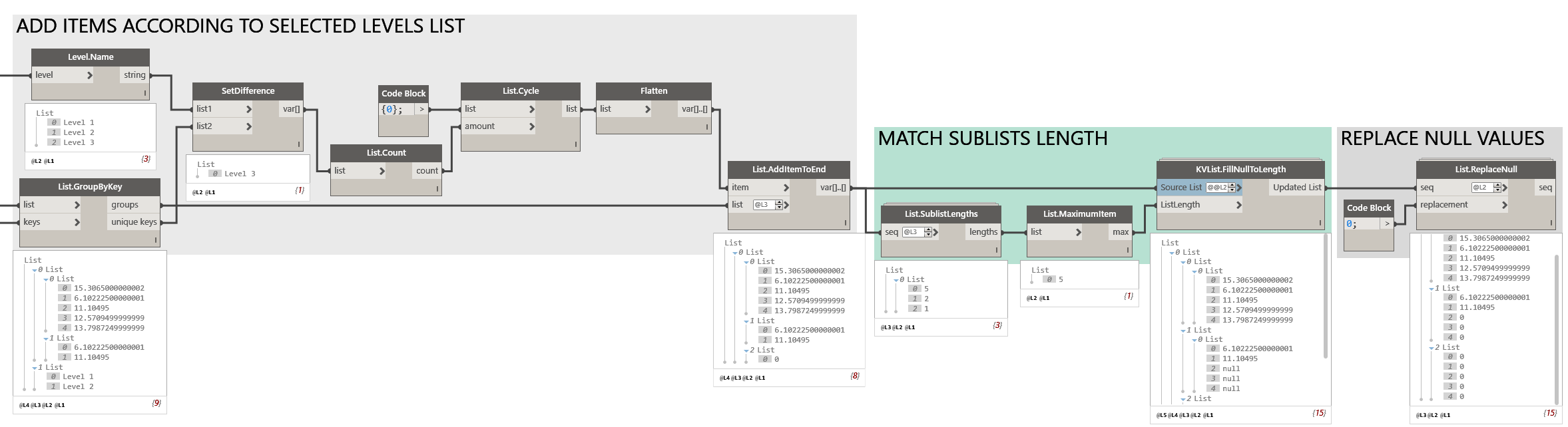

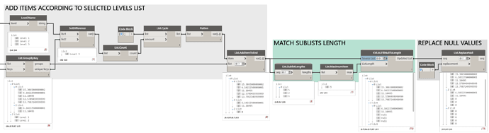

Here is the complete workflow (waiting for your feedback :slight_smile:) :
List.SublistLengths and ReplaceNull are from Clockwork
KVList.FillNullToLength is from Chynamo

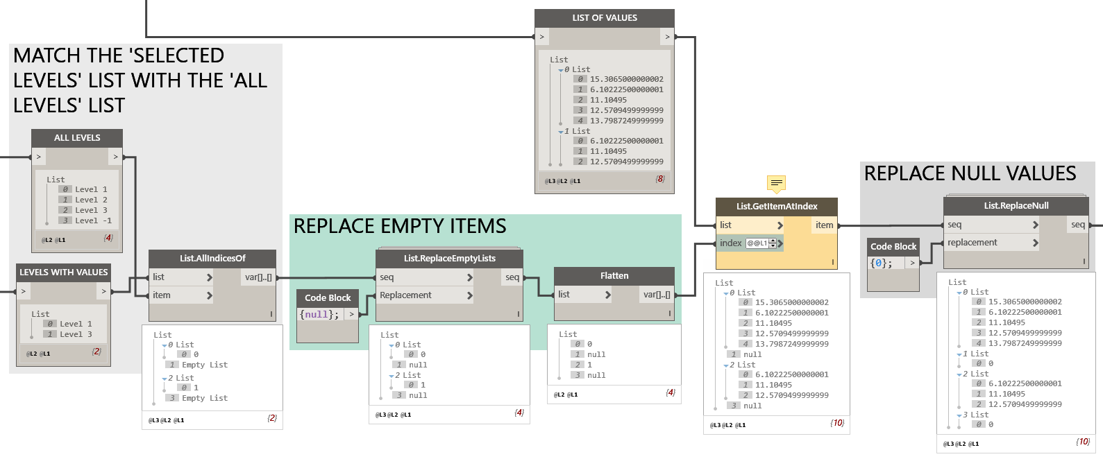

This should work (List.ReplaceEmptyLists is from Clockwork also):
To sum up, List.AllIndicesOf returns empty items where needed, I replace these empty values by a ‘null’ value, that’s why List.GetItemAtIndex returns a warning, but also a list that should be complete and in the expected order. After Replace Null, you get at least one value per level.
I would have to search a little bit more in my notes to improve this if needed (something with List.Map maybe).
