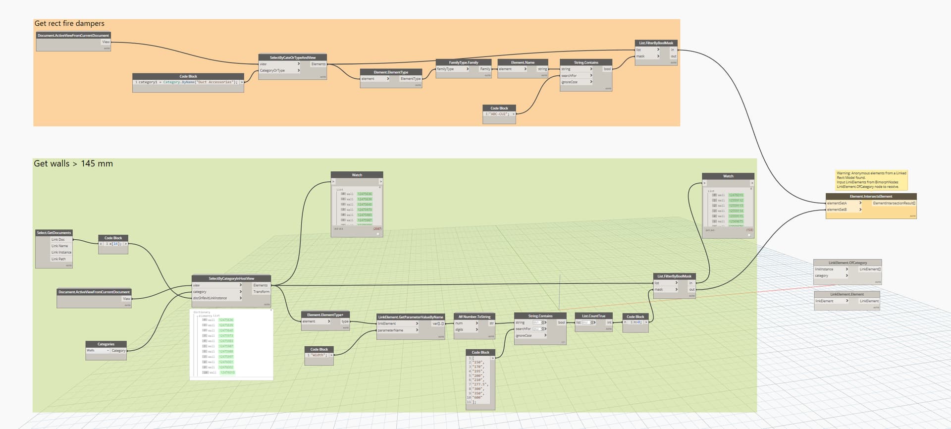

So I want to check for intersections between some walls and some firedampers. I tried to use Bimorphs node IntersectsElement, but apparently I also need to use either LinkElement.OfCategory or LinkElement.Element.
I have tried LinkElement.Element, but I can’t get it to work. I would rather not use LinkElement.OfCategory because I want to only get walls from the active view.
Are there any way I can use this IntersectsElements and still only get walls from the active view?

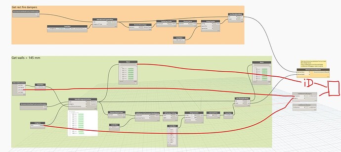

Get Id’s and use them to get LinkElements with that Id’s.
But it would still find all walls in the linked model before filtering by ID’s, right?
I don’t want that because the model is too big and heavy for that.
Did you measure exact times? It’s rather fast, as i remember.
I couldn’t measure the time because Dynamo and Revit is just “freezing” every time I try to run the script with all the walls.

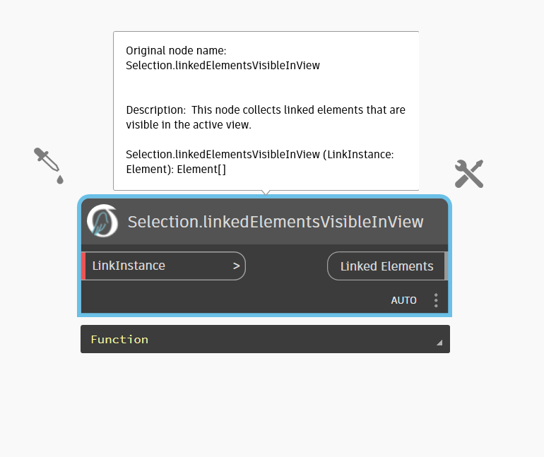

havent tried but sparrow have a node link.element.visible in view, and then filter for walls…not sure if it could help
