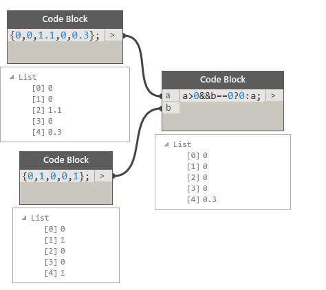

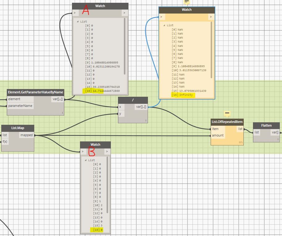

In List A I have a value [16] = 14 714 while list B [16] = 0
Is it possible to redefine the A list with one condition:
if B = 0 and A> 0, then A = 0

thank you it’s perfect
